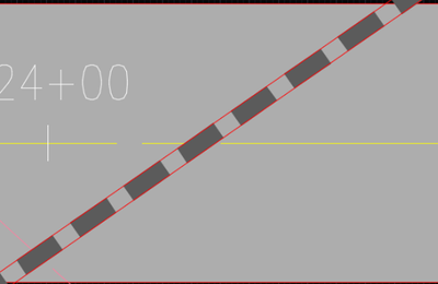

I want hatch my pipe network this hatch pattern. where can I find this hatch pattern?

Thats probably a linetype rather than a hatch.
Change your centerline line type to dashed, then in the plan tab tick the 'specify width' and the linetype will extend to the outer line of the pipe width.

Thank you for the reply. I was hoping for a hatch pattern (solid and spaces).

Our pipe style utilizes a custom hatch pattern to mimic what you have shown in your example.
It's just a simple pattern definition that has been added to our ACAD.pat file:
*SDPIPE, Pipe Hatch
0, 0,0, 0,.05, .85,-.75

Is this a Custom pattern? How would I insert this into a style?

Yes, it is a custom pattern that would need to be added to the acad.pat file or configure CAD to find a custom one.
Once the hatch is available configure your Pipe Style as shown in this image.

Is the Hatch Pattern created by you, or available somwhere?

You will need to open your Acad.pat file with a text editor and insert the following code:
*SDPIPE, Pipe Hatch
Or create a text file called sdpipe.pat with the code above and load it.
This article has more info: How to install custom hatch patterns in AutoCAD
