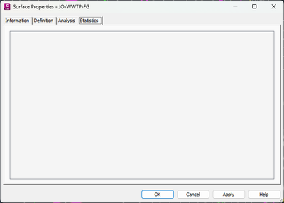

Cadguru42
I'm back to working on this project where I used Grading Optimization. I added a new zone, used a drainage line and a low point, ran GO and told it to update the existing finished ground surface in the drawing. It creates an empty surface and didn't actually update the surface.
It's been a few months since I touched the surface. Anyone know why my surface would be empty when I tell GO to update the surface?
C3D 2024-2026
Windows 11
32GB RAM
