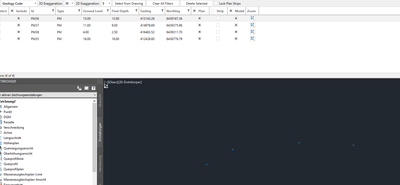

I'm starting to use the geotechnical module; I've 4 x 2m deep boreholes trying to add in a csv format (mainly as I've never heard of AGS). It took me a while to get my csv files correct in the file check in france they use ; not ,
the create submission is fine
but went I click next on Location selection I get ...screen capturescreen capture
Le cast spécifié n'est pas valide = The specified cast is not valid
I use an english version of C3D in France so the french isn't a surprise (besides the spelling mistake).
I get the same thing with the sample data from https://knowledge.autodesk.com/support/civil-3d/troubleshooting/caas/sfdcarticles/sfdcarticles/Geote...
I am currently have a student license if that makes a differnce, I have restarted, uninstalled and reinstalled the module, double checked all my csv files, searched the forum so I'm now out of ideas.

Hi
Please test again using the sample data, using the files:
Location Details.csv
Field Geological Descriptions.csv
Orientation and Inclination.csv
All other files should be ignored.
If you still get the problem, it will most probably be due to local language settings are your machine. My guess is that you are using commas instead of points.
If this is the case, you have two choices, edit the CSV file to match your local settings, or set the PC to use English.

Hi @Anonymous ,
I was able to import your data without any error see screenshot below:
Can you test if this issue is possible a point/comma problem?
  1. Go to your Windows Regional Settings and check if the Decimal Separator is set to "." (point)
  2. If not, set it to "point" and use the "comma" for the grouping similar to the screenshot in this article: http://knowledge.autodesk.com/article/Geotechnical-Module-When-trying-to-import-borehole-data-the-mo...
  3. Restart you computer and import the CSV data into the Geotechnical Module again

Karstan, it's worked thank you so much, I was really worried that there was major problem.
Now all I have to do is learn how to use the rest of the module's functions ...
