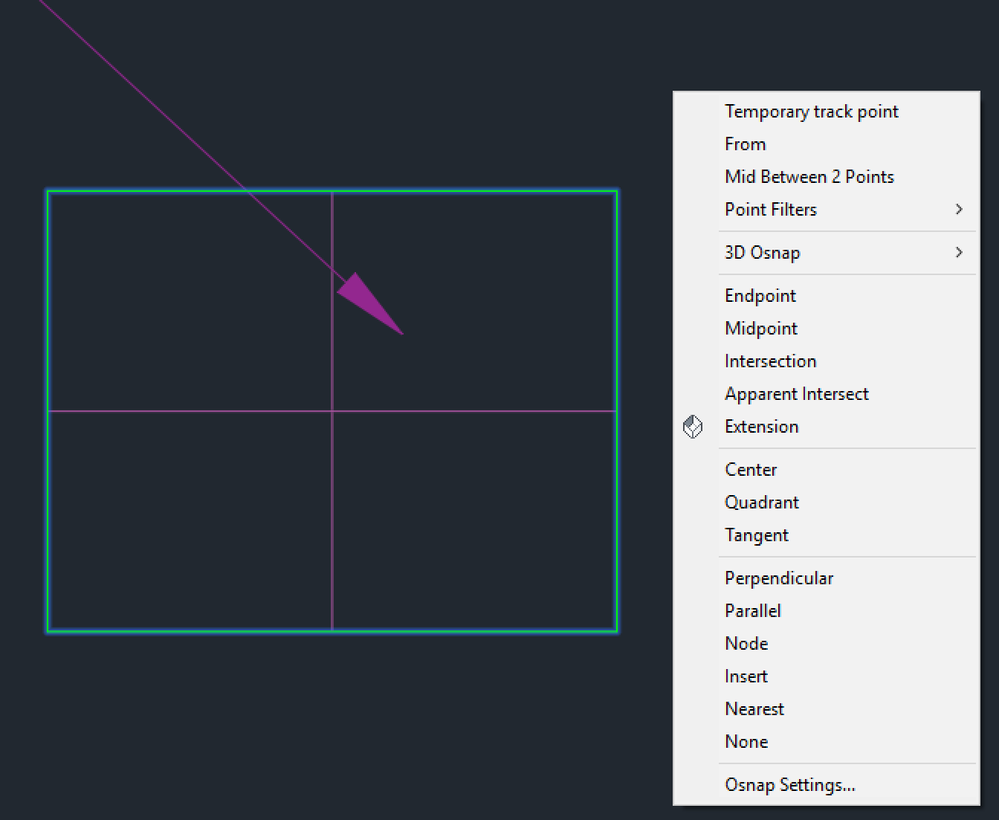

Joe,
I looked at your Post #4 and thought, "That's handy. Why hadn't I noticed it before." It's amazing what you don't see when you're not looking for it. I had also not noticed, as Jeff mentioned, that "Geometric Center" is NOT in the right-click menu.Track_1.png
Dave

Message 25 of 36
AllenJessup
@Pointdump Dave, It's there in 2019. Also the command line alias is GCE.

Joe-Bouza
Hi Dave
yes very peculiar. I have a hunch Geometric Center comes from Architecture vertical
