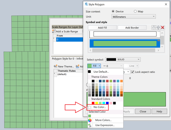

After Drag-n-Dropping the Shapefile into your drawing:
In the Planning & Analysis Workspace select the feature layer and click Style.
Select the Polygon Fill and choose "No Color".
Dave
