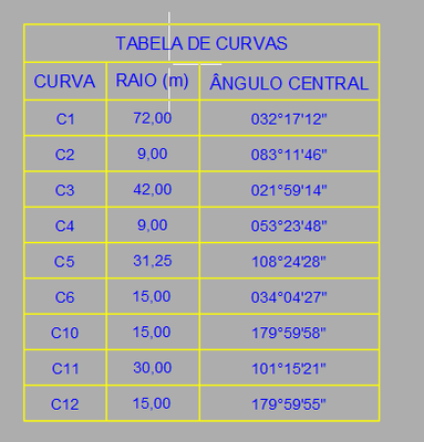

Hi all,
How are you?
How can I find 7 - 8 - 9 tag numbers, please?
Fabricio

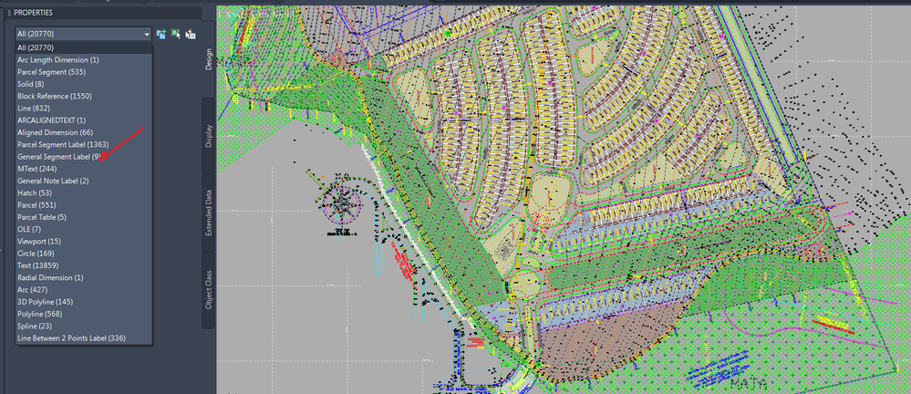

Isn't alignment label, just a label.
Yes! I've already tried select similiar and didn't work.
When I select everything (Crtl+A) and erased that worked. But I wanna delete all my drawing.

I have just 9 General Segment Label (C1-C2-C3-C4-C5-C6-C10-C11-C12).
I don't understand why are missing 7-8-9 labels 😵

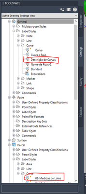

I have two labels style with " Table Tag". It is the problem!!
I don't use table tag in "01-Medidas de Lotes" Style and it can't be deleted.
just wanna using Table Tag numbers in "Descrição de Curvas" style.
Help me, please guys!

You can renumber or remove the parcel labels. Renumbering will free up 7-9 for your curve labels. From your other screenshot you have quite a few parcel segment labels. 7-9 are maybe there somewhere.

F.Camargo
I have about 400 label in that Parcel label style "01-Medidas de Lotes". I cant' delete that style.
But that style causing that issue, I couldn't renumbers the curve General Curve Label Style "Descrição de Curvas" (1, 2 and so on cause that number is already existing in "Table Tag" Parcel label)
Can I overwrite the number on "Descrição de Curvas" style? There is no problem duplicated the numbers in different style for me.

It have a label style named "Descrição Curva" in General - Label Style.
And other label named "01-Medidas de Lotes" in Parcel - Label Style.
Are theses styles have the same Component name: Table Tag? I can't not using the same number for that styles.
is there any option to allow to duplicated table tag?
