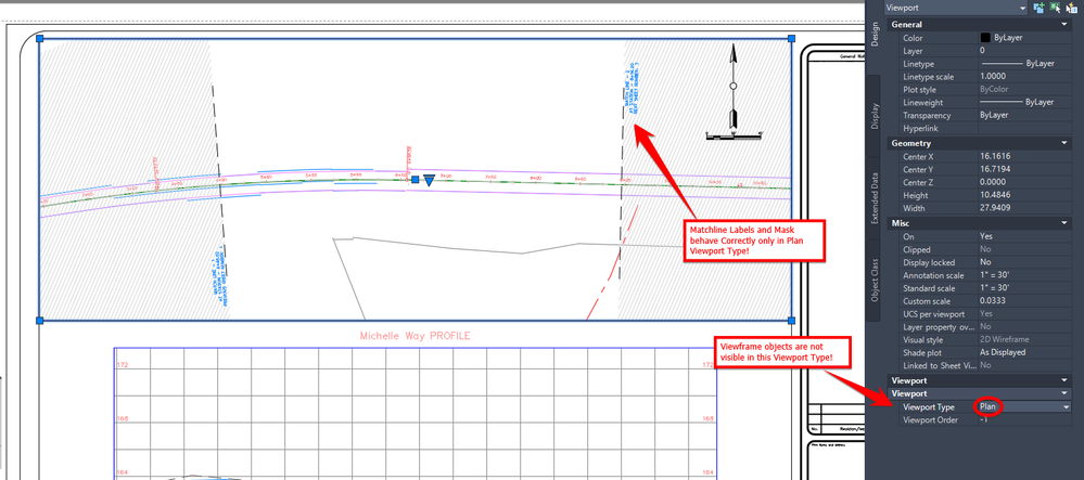

Civil 3D Viewframes are not visible in the Plan Viewport Type, this is independent of any layer or style settings! please see below screen captures to clarify what I mean.
since, we want to keep the Viewport type correct (Plan)! unfortunately that means we can not have the Veiwframe Labels show up!
A common work around is to use the Create Sheets command to name the Layout Tab with the station range, then use an AutoCAD Field to capture the Current Tab name per screen captures below!
hope this helps,
