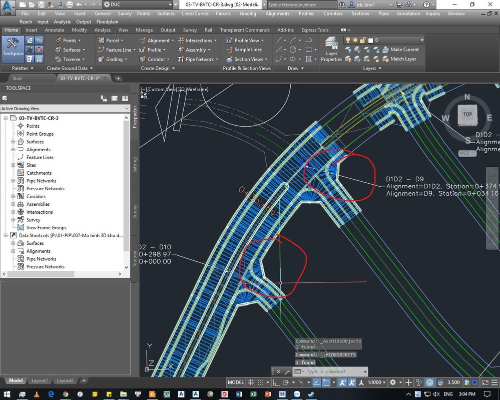

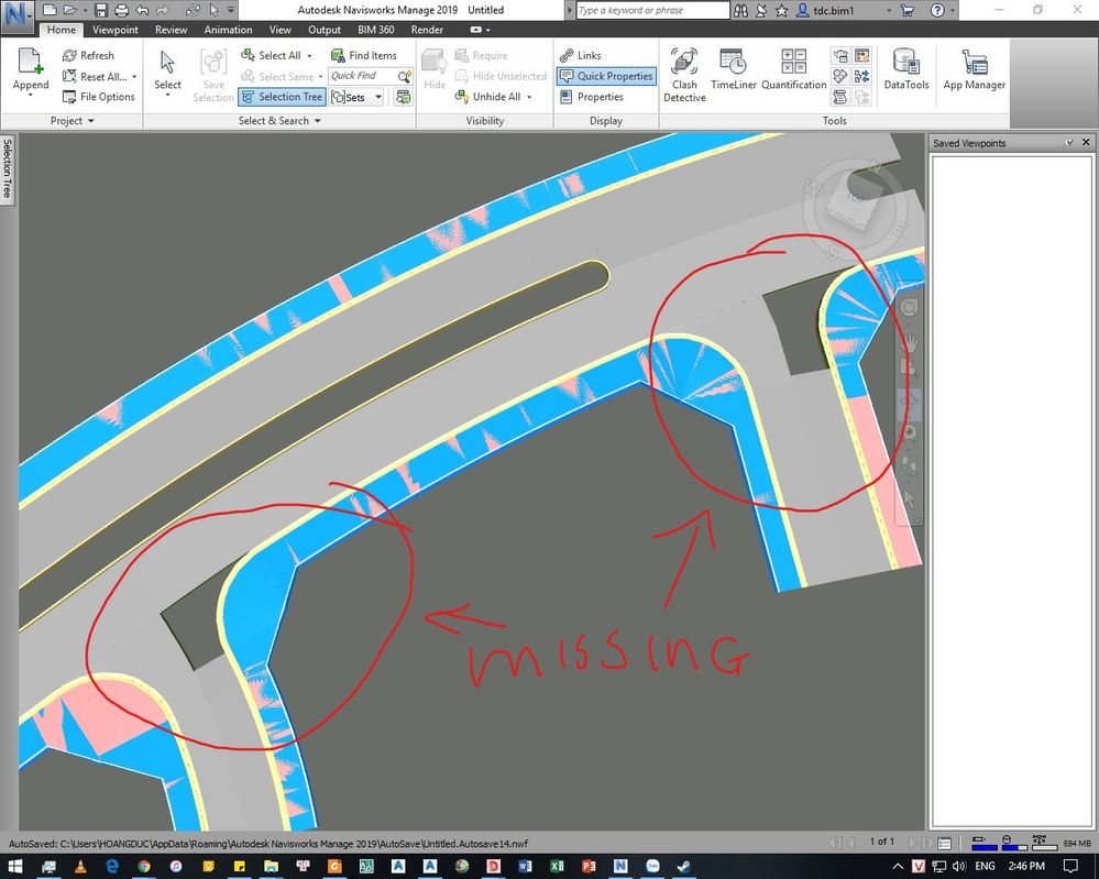

Hi Everyone,
I am trying to extract Corridor Soilds with my custom Subassembly to Naviswork.
I dont know why with my model view corridor still have but when extract it to Soilds - it missing!
Below is my dwg and Pkt file!
Any suggestions?
Thanks for your time!
Soild extract missing Curb, Even medianSoild extract missing Curb, Even medianCorridor is correctCorridor is correct

When I rebuild your corridor every region rebuilds, except this region. It disappears.
Now I suspect it might be because I don't have access to the macro's or .net that you're using, but I would rebuild your corridor and look at your events in Panorama
These are the events I'm getting.

Hi @taophatxit ,
What you have is a corridor workflow issue as you are creating an assembly that targets horizontally and becomes length equal to zero. What you can do is to split the region. See images below as a guide and attached revised dwg.
Guide 1Guide 1Guide 2Guide 2Guide 3Guide 3
For more info about corridor solid that transition to zero see 35:57 to 42:15 <AU Class CI123653 Link>
