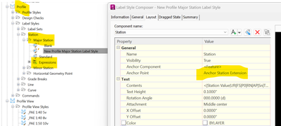

cwr-pae
You can use an expression in profile labeling just like you do in alignment. The label is not under "Profile View" but under "Profile". Enter the expression and create the label and apply just like an alignment.
If you want the label at the top or bottom of the Profile view, set the label 's anchor point to 'Anchor Station Extension' then set 'Dimension Anchor Option' (in the properties palette) to "Graph View Top" or Graph View Bottom" and 'Dimension Anchor Value' to "0". Any adjustment to placement of the label should be done in the style, not the properties palette.
