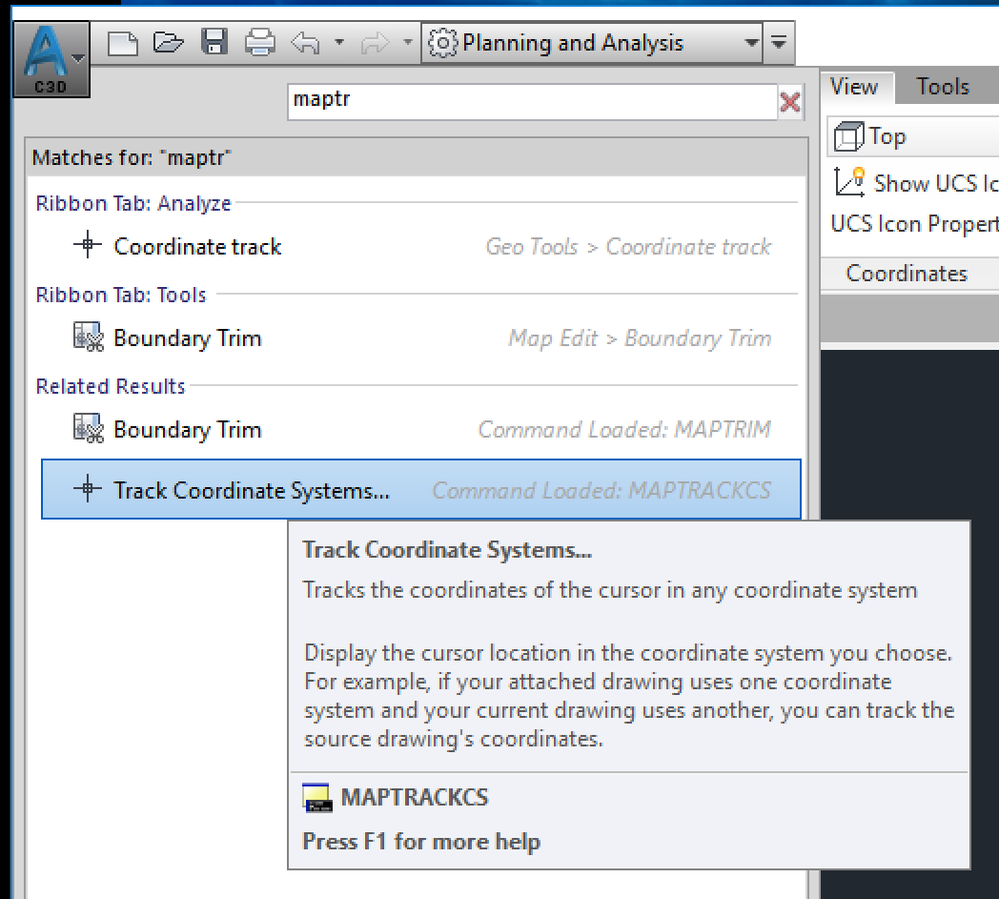

Pointdump
Erik,
In addition to Tom's excellent advice, you can also use the Geodetic Calculator or Map Tracks:GeoCalc_1.png
