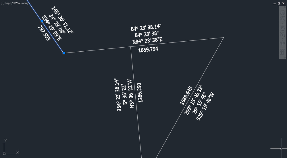

{General Segment Direction},IF({General Segment Direction}>=pi & {General Segment Direction}<=pi*1.5, {General Segment Direction}-pi,IF({General Segment Direction}>=pi*1.5 & {General Segment Direction}<=2*pi, 2*pi-{General Segment Direction},{General Segment Direction})))
I named mine "Directionless Direction", set the Format result as Azimuth, then created a style using all 3 types to verify the output (Azimuth, Directionless Direction, Bearing) and this is the result:
Mensaje 6 de 6
MMcCall402
I bow to the master.  Elegant solution.
