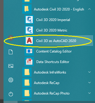

OK. You can do this. Shut down AutoCad.
Reopen AutoCAD but this time do this:
Go to START button=>Autodesk Civil 3D 20XX=>Civil 3D as AutoCAD 20XX.
