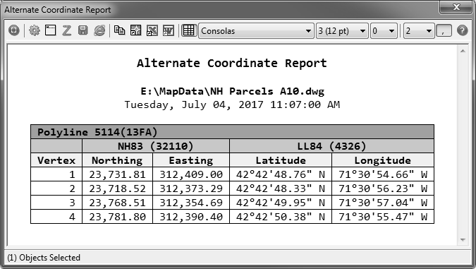

TerryDotson
If obtaining the Lat/Long of any object is your goal, the Alternate Coordinate List tool in DotSoft's C3DTools will provide this dialog, simply select objects.
The results can then be exported to Excel, Word, or a Table in the drawing in a single click.
