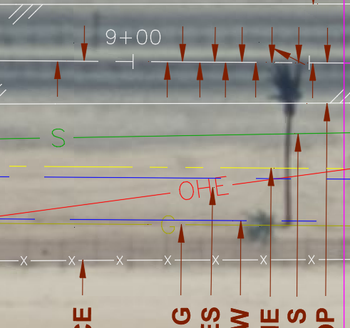

I have searched for an answer and can't find one. I have spent a lot of time aligning dimension text to look like the picture below, specifically the text from the center line. I have them offset from one another fine with the adjust space tool. Is there a setting for this?

I want my text to justify left like the first pic and not justify center like the second pic. I have to move them with grips and it is time consuming.  I am hoping someone can point me to a setting or something that will make the text auto justify left so at the very least I can snap to a construction line.
First pic:
Second pic:

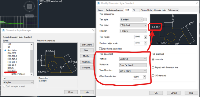

I coincide with @rl_jackson. It would be better to post this question in the AutoCAD Forum. However, trying hard to help you, here I show you what I think might solve that.
In the Dimension Style Manager, select the style you are using for dimensions and Modify. In the modify window, select the Text tab, then, in the "text placement options," set what is better for you to automatically place the text of the dimension when added in the model in the location of your preference.
I hope this helps. Best regards!
