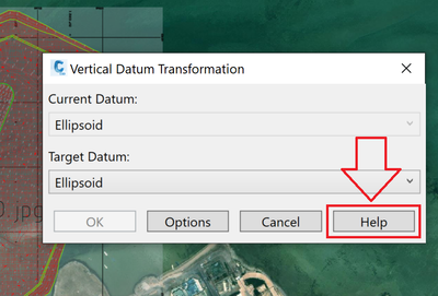

When I try to use Vertical Datum Transformation, it tells me that the Geoid Model is missing from C:\ProgramData\Autodesk\C3D2023\enu\Geoid Models\
I got a Geoid file from our Trimble dealer but it doesn't work. It is a *.ggf file.
Where do I get a geoid file that would work for Vertical units Transformation?
What would the file extension be?

Hi @AEC_Cadd,
The files you need have a .bin extension. Geoid 12B is "g2012bu0.bin".

Do you know where i can find one?
Pointdump
@AEC_Cadd,
Hit the Help button lower right and it'll give you this link to a site where you can download Vertical Datums:
https://www.isgeoid.polimi.it/

Thanks, I appreciate your help
