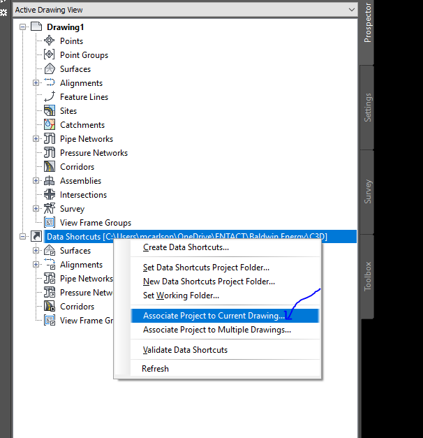

If you're in a drawing that has or will have DREFs to Project A and you want it to always open the Project Shortcuts for Project A when you open the drawing each time.  Simply path your Prospector to Project A and right click on the Project Shortcut path and select "Associate to Project to Current Drawing".  Then save drawing.  Each time you open this drawing, the Project A Shortcuts will display.  Please see below:
You could do the same with Project B dwgs.
As @tdivittis indicated, if you're both working on the same project, setting up a network project folder with one Project Shortcut folder structure is best.

It sort of is....ugh.  It saves a relative and full path.  I've not seen any documentation on behavior, but it appears to look in the 'relative' path first.  This way, if you transfer an entire project folder (several assumptions made there, of course) to a USB to work at home, etc., all of the references will behave properly.  The XML files in the DataShortcuts folder are ONLY used when actually creating the reference.  Once reference, those XML files are completely ignored (as far as i can tell, anyway.)  I've been working this way for quite a few years, now.
Thanks for the screen shot, Mike.  I couldn't remember what the heck that was even called, the associate to project thing.  To the OP, there is no magic in that association.  I believe it simply sets that shortcut folder to current when you open the drawing back up.  It is quite nice that it sets it for you, don't get me wrong, but beyond that, it has no effect on the referencing, at all.

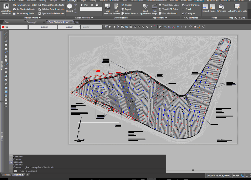

Side Note: We leverage the Manage Tab\Manage Data Shortcuts option in C3D 17 and 18 at times during design.  We find this interface useful because you can re-associate an existing drawing DREF to a different (updated) DREF source within the project.  I agree with your caution about this, but sometimes in a Design setting, there are different phases and as the design evolves, different source files may be created to separate design approaches and it's nice to be able to just update the DREF behind the scenes to keep everything that's associated with original DREF in Production Drawings the same.  Anyway, I show a quick .gif below showing this interface.  Have a good evening.

Thanks all for the information/education.  We do associate DS folders with drawing files but it seems a bit sketchy in day to day use.
For those setting up one network DS folder with all projects there in, do you have any archival issues?  What makes this setup work better than setting the DS folder in each project folder, sketchiness of the associate function?
I missed the "connect" button between the left and right pane yesterday in manage.  Many thanks for bringing that to my attention.  Is there a way to do this in bulk?  the Data Shortcuts Editor did not work, operator error?

Data Shortcut Editor is the only option I know of to edit DREFs in bulk without opening each drawing.  I haven’t had to use that option very much though.
