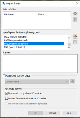

When i open it apear all text in a colum. Can u import points în civil with this cvs file?

I've re-ordered the points to be in the PNEZD format. See uploaded file.
Jeff_M
@alexandru.murariu1989 , You could reorder the columns (data separated by commas in a text file are 'columns') in Excel and resave as @hippe013 did.
Another option would be to add a UserDefinedProperty "Count" as an Integer type to the drawing, then create a new PointFileFormat with the columns consisting of Count, RawDescription, Elevation, Easting, Northing. You will need to edit the first line of the csv file to be:
# Count,Name,COTA,Position X,Position Y
then SaveAs and change the file format to UTF-8  (it currently is UTF-8 with BOM). You will then be able to import the points using that new PointFileFormat. If this is something you will need to do again on another project, makes sure to save the PFF and UDP to your template.
