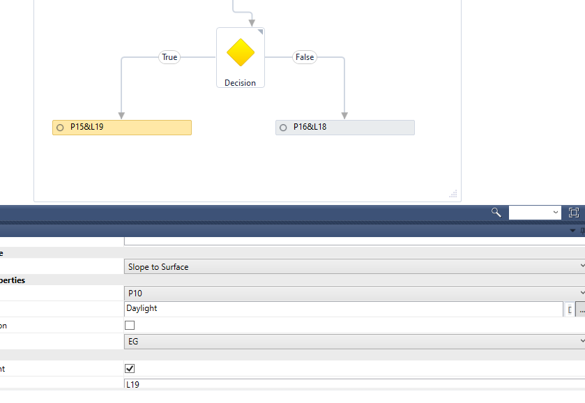

  5. You have the EG surface created under your target parameters, but you do not have a geometry that targets the surface.  This can be done doing the following:
    1. Create an auxiliary point
    2. Create a decision to switch between cut and fill
    3. Have two separate sequences to perform daylight condition.2022-01-11_HELP-04.PNG2022-01-11_HELP-05.PNG2022-01-11_HELP-06.PNG2022-01-11_HELP-07.PNG
