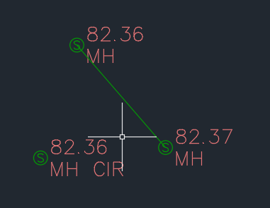

I'm fairly new to civil 3d, and I'm trying to figure it out what codes I should use in my survey data to create a three-point circle. Whenever I try using the circle code, I get an error message saying that Circle command failed , and no linework is created. If I use only the curve codes, I end up with a semi-circle closed, or not, with a straight line.
Here's the codes I've tried:
CIR / CIR / CIR
BCV CIR / CIR / ECV CIR
BEG CIR / CIR / END CIR
BCV / OC / ECV CLS
Do I always have to input the diameter of the circle in the code line?
Thanks!

rl_jackson
To create a circle from three points:
You take a shot, for example I have a figure code for WW which stands for Wet Well (Pump Station), and use automatic line work so I don't need the B or BEG
Desc first shot: WW1
Desc second shot: WW1
Desc third shot: WW1 CIR

ppereira7H9TH
Hi @rl_jackson ,
Thank you for your reply. I tried using the CIR code only in the last survey point like you suggested, and it only works for certain points, but not all. I thought that maybe it could be the figure prefix configuration or something, but using two different manholes, one works (first picture, MH works, CON doesn't), and the second one doesn't work (second picture of MH points). Do you have any idea why that would happen? I just receive a Circle Command Failed notice but nothing to further let me know why it failed.
Thanks!
Message 7 of 8
rl_jackson
I'm thinking that if you have those two manholes in the same drawing you'll need to have the numeric, i.e. MH1 MH2 MH3 etc...... Then it should work, I would think the same would be true with the CON as well. Personally I always have the field start coding with WW1 WW2 etc.... when there doing location. Otherwise usually a failure means it could not solve a solution for the circle.

ppereira7H9TH
Hey @rl_jackson, I made it work. What you said about numbering all the points was very helpful, but one thing that I noticed is that I had to include CIR in my first point of each circle, and not the third.
