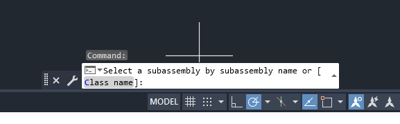

Corridor Transition
I want to select subassembly by Name .How can i do it?
Thanks in advance

Hi @Elmoataz.Bellah.Salem, Are you working with custom subassemblies? if so, and you are using Civil 3D 2023.2 or newer, you can harness the power of subassembly management. Go to the toolbox, look for the subassembly collection, and right-click on the subassembly you want to select:
This will select all the subassemblies.
Alternatively, you can open the quick select window and create the following selection set. At value place the name of the subassembly you want to select, then hit OK and you'll have selected only that subassembly (see the following images):
My subassembly was called, ShoulderDemo
Give it a try. I hope this helps.
