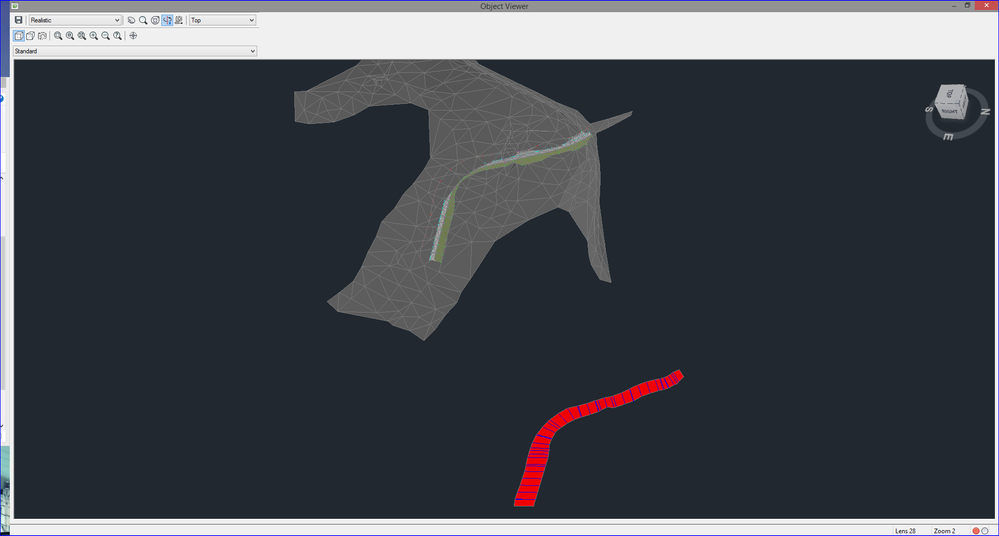

I would like some feedback on whats going on here.
I have gone through the basic steps to create a corridor for a basic driveway. The corridor and surrounding grading surface seems to look right on Object viewer. There is however a shadow or something of the corridor. It shows up in red. If you see my image you will notice its hanging in space underneath my surface.
Is there a reason for this? Might this affect my grading and ability to create a contouring lines for my grading surface?

Can't really tell much from the images. But it appears you have something in a style (possible the surface style) is set to display at elevation 0. If you can post the drawing someone might be able to find what it is.
troma
I concur that it's probably something set to display at elevation 0.
Can you do a 3D orbit in model space and see this? Then can you select it and find out what it is?

Your corridor style is set to display the assembly insertion stations in Model view.
Here's one of my corridors with a similar style.  Note that I have the parameter override stations displaying in a different colour.  The corridor itself is not used for surface construction - the points, links, and shapes contained within it are.
