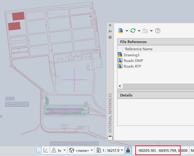

Hi everyone, I'm a civil engineer student at the university of Padua. Currently I'm developing a master dissertation regarding interoperability, Open-BIM etc.
I ran into a problem: I have 3 Civil 3D files, one with the EG surface, one with roads surfaces and the last one with railways surfaces ( i did on purpose to create different files to simulate a "real" workflow). All three files are located using the command: geographic location - from map. My goal is to insert the two surfaces (roads and railways) in the toposurface file (EG) obviously by not changing their position. So i create a link data but when i try to insert them the surface are in another place different from where they should be. I also placed the UCS in the same point but nothing change. Did someone have the same problem ? Could you help me find the solution ?

Neither drawing uses coordinates within the range of Adindan.UTM-38N. Using the GeoLocation Command to shift your drawings won't work.
Can you post the Master Plan drawing?
If you use GEOREMOVE Command on both drawings, then XREF them into a new Metric Template, you'll see that coordinates for both are wildly different.
As to how to fix things up, I'm not sure. You have a lot of Surfaces and Corridors in need of repair. Honestly, I'd start over. Probably not what you want to hear.

cristiano.zuccarello
Dear Chicagolooper,
thank u very much for your reply. I have already done it. But when i create a data shortcuts and then a reference of one of the surface, the software automatically past it surface in a different place.
something that i notice and that could help find the solution ( at least i think) is regarding the property settings of the surface--> general --> minimum coordinates etc ( thery have a certain number)
but when I move the cursor over the surface itself in the bottom tab there are other values that are completely different.
And when i create reference in another file, the surface is placed taking in cosideration the first coordinates.
I thought that if I moved the UCS or the geolocation point the minimum and maximum coordinates value would change, but it's not. (sorry for my english )

You have not established the geolocation correctly and this causes insertion errors when you xref. Your reference point  at the DMP is located at Lat/Long 11.601817 and 43.074142 with projected x,y coordinates at 289906.410595, 1283030.094505 (Adindan.UTM-38N EPSG 20138).
If you properly assign Adindan.UTM-38N to a drawing, you'll see the individual ref point has BOTH the correct Lat/Long AND the correct x,y for the same point. In your drawing, however, you have accurate Lat/Long and an inaccurate x,y located at 0,0 and that means your linework won't xref, paste or insert correctly. Your non-matching Lat/Long and x,y's are due to the procedure you used when assigning your drawing's coordinate system.
Although your Lat/Long is accurate your drawing doesn't have same X,Y as shown here.Although your Lat/Long is accurate your drawing doesn't have same X,Y as shown here.
The GEOGRAPHICLOCATION command is popular and frequently used but it can give bad results when used improperly. It's tricky to use.
Your existing surface uses topographic contours (Topography layer) as the definition. I suspect those contours have a projection you can use to geolocate your surface. To make your drawing right you'll need to go back to the source contours and analyze the projection so you can rebuild it in the correct spot rather than at a arbitrary location. Can you upload those contours?
Yes, I could easily reproject your contours, rebuild the surface then upload it, but as a matter of principle, I won't.Yes, I could easily reproject your contours, rebuild the surface then upload it, but as a matter of principle, I won't.

Disegno2(1).dwg has high negative coordinates. While you can move things to their "right" place, Scale and Rotation are unknown. I don't know any easy way to fix your drawings.

Unfortunately  the contours are NOT referenced against a known coordinate system. It looks like the topographic reference was abandoned or deleted and that’s not good. As it is now, there’s no easy way to georeferenced your drawings. If it were me, I would start over because the drawings don’t look like there’s a lot to recreate. You can move the topo contours and recreate the existing surface.
If you’re up to it, you can do this to establish the correct geolocation for your site.
  1. Open a clean metric template and setup the UNITS so you can view high precision lat/longs. See image-1.
  2. Use MAPCSASSIGN to assign Adindan.UTM-38N as your coordinate system. See image-2.
  3. Insert a geomarker. Go to Geolocation Tab=>Online Map Panel=>Mark Position dropdown menu=>Lat-Long option. See image-3.
  4. On command line input Latitude=>ENTER, Input Longitude=>ENTER. Go to your flashing cursor in modelspace and enter DMP=>Click away from your cursor to end the geomarker command. See image-4.
  5. In modelspace, select your geomarker=>Properties Palette=>Geometry section=>Size=>change to 100. See image-5.

The x- and y-values in the new drawing are now consistent with the assigned coordinate system. If you want to do it right, and I think you do, you can rebuild your EG surface in this new drawing. You may, or may not, need to recreate your design surface FG too. You can cut-move-and-paste your non-civil entities to the drawing, it’s your un-georeferenced surfaces that will give you problems.
