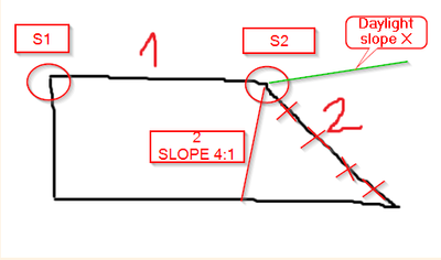

1. Where is measured the slope of the shoulder you mentioned? At 1 or 2? (see image)

I might add, the daylight slope belonging to the shoulder is set to 4:1. The daylight slope (or another word for it?) that I want to reach the existing ground is a separate subassembly from the shoulder subassembly.
1. The shoulder slope is determined by the yellow arrow in attached image (or number 1 according to your image).
2. The shoulder slope should be determined by if it can't reach the existing surface within -5% - 5% range and predetermined width A that a daylight slope is required
3. The difference between the conditions is the cut/fill slope of the shoulder and consequently the slope of the daylight searching for the existing surface within a predetermined width A

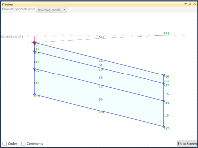

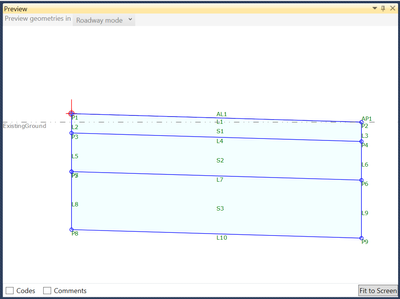

In this context, I cannot think of a way to do this directly in Autodesk Civil 3D. However, I know this behavior can be programmed with Autodesk Subassembly Composer. Check the attached PKT file (uncompress and import it to C3D). In the subassembly, I simulate the slope between the point of origin (the point where the shoulder is attached) and the terrain to know its slope value before assigning it to the shoulder. Then, I evaluate the slope value to know if the final geometry has to stick to the terrain or be drawn with its normal 4:1 slope.
These are the preview pictures in Subassembly Composer

Well, an amendment to the text you've written.
"So, I understand that the shoulder should stick to the ground if its slope, measured between its point of origin and the terrain, is between -5% and 5%." Yes. And the shoulder slope is the "outside slope shoulder" S2 (see picture below).
"Conversely, if the same slope is greater than 5% or less than -5%, then, the shoulder should be created with its normal slope (4:1) without sticking its edge to the terrain." No. The shoulder slope should, in the case it is greater than 5% or less than -5%, stop at 5% or -5%. The shoulder slope is the "outside slope shoulder" S2. The daylight slope 2 that is always connected to the shoulder assembly is only going to be 4:1 slope (because of the narrow space for cut).
The daylight slope X that is added to the shoulder assembly is only applicable when the shoulder slope is greater than 5% or less than -5%, and therefore stops at 5% or -5%. The daylight slope X is varied but searches to the existing surface. Would be neat to be able to use a "width target offset" for it.
The daylight slope X is new grass.
