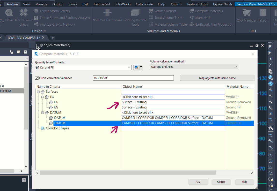

I cant get the cut and fill volume calculator to include the datum surface, it is only giving me option of just the existing surface for the surface drop down and datum drop down. Is there something wrong with my corridor that's why its not catching the datum surface created in the corridor surface tab?

Hi
before you go to compute materials you should add sources to sampled
check photo attached
yea
it is the same i assume
see photo attached
