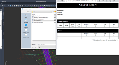

@ecfernandez the above "O" totals are just text.  we manually type these for each cross section.  I was looking for a way to automate this text.  It appears utilizing the tables listed above (as you mentioned) with some adjustments to the style of the table, we can do this.
I was using the same report as you mentioned above, but I get a blank .html page when I run the report using the selectmaterial.xsl   Would you know why this would be happening?

@ecfernandez Thanks again for your help.   I am actually working in Civil 3D 2022.  I did copy over the .zip file and ran the report.  I am getting this when I use Select Material.xsl file.  I do not report you showed above.  Is there something I am doing incorrect?
I do have 2 separate materials.
