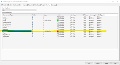

There are a few things to try/check.
1. Are all of the relevant layers on and have an appropriate plot style?
The above picture shows the layer properties that I needed in order for the colors to be plotted. The most important things are that the layers are on, thawed, and have a plot style ("Normal") which allows colors to be plotted.
The below pictures show how to find which layers you need to address. They live in a couple places since some of the layers are associated with the table and others with the surface.

OK, quick update for anyone following this thread...
At least regarding C3D 2022.2.6, this issue exists. Researching this in 2022, we determined that the table swatches are placed onto the current layer when inserting an XREF into the sheet file. If the current layer is a non-plotting layer, the swatches will not display. If you relayer the XREF, the swatches stay on that original current layer. Also, you may be using the XREFLAYER variable to force xrefs to a layer regardless of the current layer. The swatches will still use the current layer.
The solution is to detach the XREF, set a layer current that does plot, and reattach the XREF!
