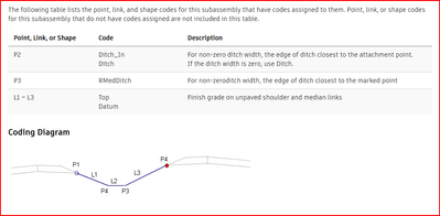

My first issue is labeling the links and points of a LinkSlopesBetweenPoints. I cannot find what name if there is one for this subassembly. I can label them by seting the default to a label but this labels more than I would prefer.

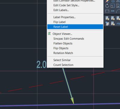

Second issue is if you hold CTRL on a Code Label and move it to a dragged state is there any way to reset this?

fcernst
These are the Codes to work with..

RobertEVs
Second issue. Right>click on a code label and reset.

TJMaust
Unfortunately that subassembly doesn't actually expose codes to edit. The link are Top and Datum, as point out by fcernst. But you can't edit those in the code set style dialog box, the image above is from a fresh corridor where I "import" the codes from that subassembly and as you can see...nothing.

ecursonmsmm
If I put any of those in p2, p3, l1, l3 ... none of them label.

ecursonmsmm
I wonder why I don't get that pop window.

Message 8 of 12
ecursonmsmm
Thats what I thought. This should be resolved for all default subassemblies. I cannot even get this subassembly into the composer to add labels as it is buried in the C3DNETSubassemblies Imperial.pkt which you cannot open. Does anyone know how this is created so I can recreate it for future use.

ecursonmsmm
You must not have CTRL clicked the labels to get that popup. I was under the impression that you needed to have that particular label selected to reset it.

RobertEVs
No. Ctrl>Click will only drag it. You have to bulk reset code labels to get rid of the drag one just one.
