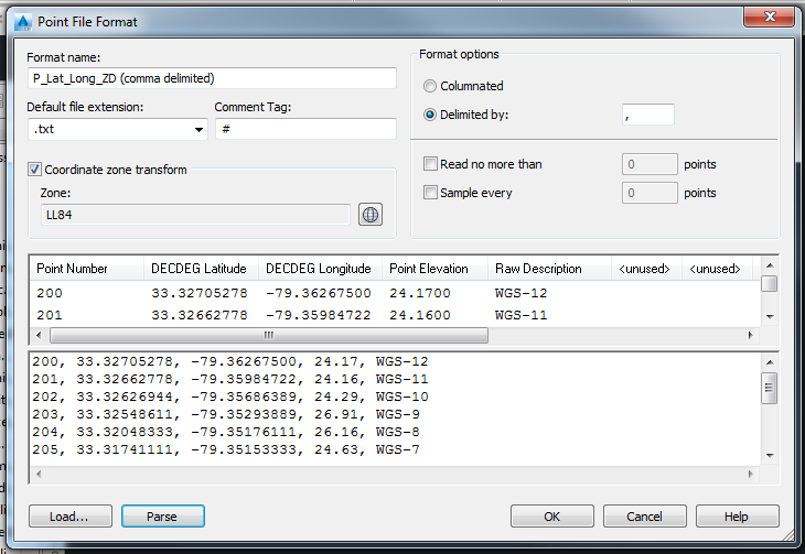

I am using Civil 3D 2017.
Have been trying to import a text point file.  The message I keep getting is "No points were transferred from the source".  The file is shown below for your reference.  The point file format I am using is also attached as a screen capture.  It has been some time that I have had issues importing a lat-long file, but do remember my first day with these same issues, seems like it is back to haunt me.  It has been my experience that the process is very temperamental.  I tried csv file format, then changed to text, remembering someone commenting that text files worked better, except now of course.  Any advice is appreciated.
200, 33.32705278, -79.36267500, 24.17, WGS-12
201, 33.32662778, -79.35984722, 24.16, WGS-11
202, 33.32626944, -79.35686389, 24.29, WGS-10
203, 33.32548611, -79.35293889, 26.91, WGS-9
204, 33.32048333, -79.35176111, 26.16, WGS-8
205, 33.31741111, -79.35153333, 24.63, WGS-7
206, 33.33166389, -79.35921667, 25.36, WGS-3
207, 33.33124167, -79.35591389, 26.8, WGS-4
208, 33.32997500, -79.34913611, 30.88, WGS-5
209, 33.32951944, -79.34460833, 24.65, WGS-6
210, 33.33660000, -79.36967778, 12.46, WGS-1
211, 33.33810556, -79.36779167, 10.85, WGS-2

Pointdump
Chuck,
Check the "Coordinate Zone Transform" box and select LL84. Then it'll work.

Pointdump
Chuck,
That dialogue box is just telling you that you don't need to tell C3D what coordinate system your imported points are in if they are not going to be transformed. If your drawing is in State Plane and points are LL, then you definitely need to check that "Coordinate Zone Transform" button.
The comment tag is used to "hide" the first row of your point file. If you use "#", then your first row can read "#Durn these durn point file formats!" and C3D will ignore that and still import your points.
Not sure why your point import is failing. Can you post your point file? Sometimes it's some small detail, like a letter in one of your point numbers.
Dave

Pointdump
OK, I get the same thing. Interesting. I learned something. The points will import into your LL84 drawing if you choose PNEZD, but of course the drawing wouldn't be very useful.
But if you change the drawing's coordinate system to SC83F, then your point file imports with no problem using the PLATLONGZD format.

cturlington
Dave,
Both approaches allow the points to import, but they do not appear to land at the correct location.  I guess this demonstrates the limits of the software to attempt interpretation of  geographical coordinates in a "flat" environment.  It seems like the bottom line is; if I need to work with true geographical coordinates, I have to use software that interprets the 3d coordinate systems and not just grid based ones.  I think that is interesting, was not aware.  However, if I am incorrect with my assessment, please do not hesitate to let me know.

Pointdump
Chuck,
"...limits of the software to attempt interpretation of geographical coordinates in a 'flat' environment."
"...they do not appear to land at the correct location."
Fair enough assessment. But consider that EVERY Projected Coordinate System is based on a Geographical Coordinate System and a Datum to tie that GCS to the round world. C3D does a pretty good job of converting Lats and Longs to whatever Projected Coordinate System you use, and since all work in this world is done with length units, I think it's best to stay in Projected Coordinate Systems.
