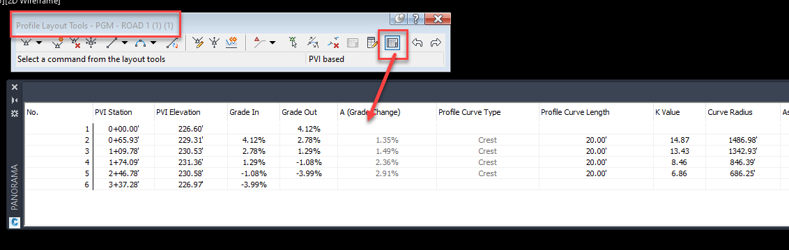

When you create the profile for the 2nd alignment, how you do take exactly the same profile from road 1 to ensure there are no discrepancies and it ties in correctly?
I just copied the station/elevation/curve data from the profile grid view here (see attached image).
Let me know it if works!
