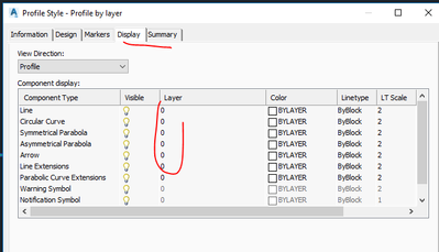

Well, specifically it would be great if there was some way that I could associate a profile to its own specific layer when it is created - much in the same that surfaces are.
So far I've worked out how to create a new layer when profile is created (I've attached a snip in case anyone wants to know), but I can't find how to edit the default profile style such that the new profile will be controlled by this new layer.
I'm sure I'm close - but can't find it! Help.
Cheers
Mick

OK worked it out. Ensure that the default style for profile creation has the layers for the various profile components set to Layer 0. I hope this helps someone.

thanks Neil, you were probably typing as I was on my own little voyage of discovery. The combination of those command settings and layer style works for me. thanks for the reply
