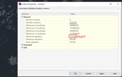

Trying out the new >>>Automatic Ground Classification<<< in ReCap. Not getting the expected result, which would be Ground Points Only.
Here's the Point Classifications of my LAS file:
2109533 unclassified (1)
2958253 ground (2)
2677 noise (7)
723837 water (9)
2527 rail (10)
1778 bridge deck (17)
2 Reserved for ASPRS Definition (18)
When I use the new tool and create a surface in Civil 3D I get 5,795,275 points. What am I doing wrong? Point Cloud (EPSG:2967) >>>Link<<<.

Also, there is at least one point in the data reporting a negative elevation -513.08, so ReCap isn't to blame for that.   Anyway, run that through the new ReCap and see how close to the 2,958,253 ground points it returns.  I'll try our ground tool to see what it shows, it works differently than RapidLasso's LasTools and ReCap.

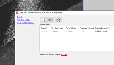

Terry,
Thanks for de-classifying my cloud.

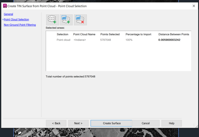

OK, with las2las I filtered out the 2 points below 0 elevation, leaving 5798605 never classified (0). After using Automatic Ground Classification in ReCap I ended up with 5797046 points. So that's a reduction of only 1559 points, and I can still see every tree in the cloud. So Autodesk has some 'splainin' to do.

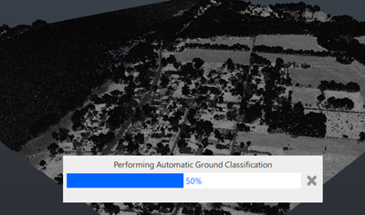

Mike.M.Carlson
Hello Gentlemen,
I hope all is well.  Please see the link below:

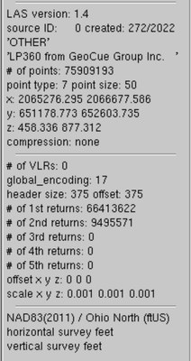

BRD_NAD83-2011-OH-N_usft_NAVD88.las
It is a small swatch from a recent UAS LiDAR data survey I did.  It is a raw unclassified .las that has a mix of trees, ground, and structures.  There's about 75MM points in this set due to 32 channel LiDAR system.

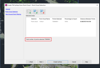

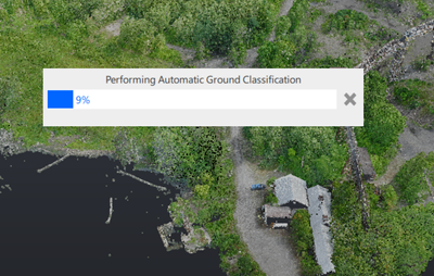

Pointdump
Mike,
Thanks for that nice data. It took about 1-1/2 hours for ReCap to crunch through its Automatic Ground Classification routine. I ended up in Civil 3D with 75899901 Points. AGC only lost 9292 Points, and I still see trees. But it did take out buildings. Until I see the trees gone I remain unimpressed. I might be missing something. I wish Autodesk would add to the Help on this new function.

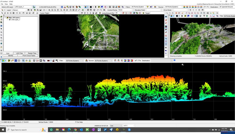

Mike.M.Carlson
Hi Dave!
Looks like you're using a good option to tackle this.  I'm using LP360 advanced and they have a recommended 2 step process for classifying ground.  Create an initial seed surface to use as a reference with the auto settings below (I also filter to last return only and note my subjective seed grid size):
Next step is to rerun algo using the Step 1 seed surface with a larger grid spacing but more stringent filtering values:

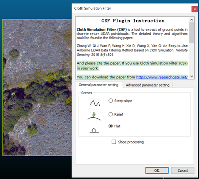

The results still aren't perfect and require some manual intervention to classify points using LP360 profile view.  In the end even if you get a dyno-supreme point cloud with noise factored out and true ground points classified, you will be left with a ton of points that Civil 3D will choke on.
Terry's Mass Importer has very slick tools to help with the large number of points.  However, the best way to define drainage features (like channels) or sharp terrain breaks is via 3D breaklines.  To me that is the holy grail if you can find an algo that will auto draw 3D breaklines for these sharp features and build a surface from that infrastructure.  So that would give you a lean and mean surface that is decimated but accurate.  Now you can use grading tools, etc and not bog down the engineering design process or drawing production workflows.  I have to do this 3D breakline conflation manually now in LP360 and it is a HUGE time suck.  However, that is part of the game if you want something defensible and accurate for engineering design.
Anyway, I wish there was an easy answer to all of this.
Have a good weekend gents.

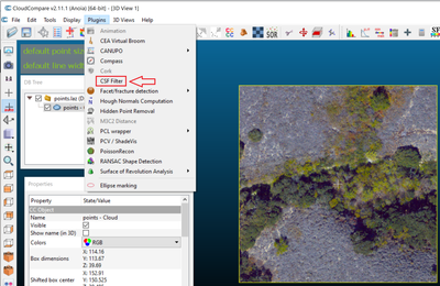

Mike.M.Carlson

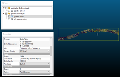

You ever try cloud compare?  That is open source and has a decent ground classification engine.  Worth a look.  Have a good weekend!

Pointdump
I use CloudCompare quite a bit. I didn't know it could do anything but filter already classified points. I'll look into that. Thanks.

neilyj666
@Pointdump Dave - can Recap do the filtering? I tend to use Cloud Compare to create a cloud of ground points (filter by 2 - it is pretty quick) then into Recap and finally Civil which is a bit of a long way round.

Pointdump
Hi Neil,
I think LAS2LAS in LASTools edges out CloudCompare for Ground Point Filtering.

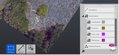

For classifying Ground Points from an unclassified Point Cloud, Cloud Compare looks like the bomb. It's waaaay faster and easier than LASGround. Whether it works better, I just don't know.

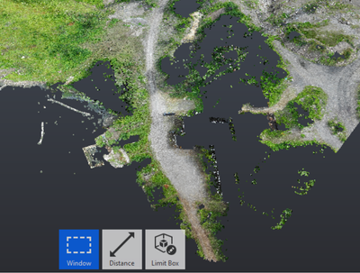

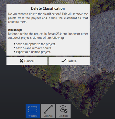

The latest ReCap update now shows the classifications, and by clicking all the other classifications off, it seems to filter ground points. But when you import the RCP into Civil 3D, all the points are still there. So unless I'm missing something it just doesn't work.

Mike.M.Carlson
Hi Dave,
It makes sense to me that the RCP insert will import all classes into C3D.  Think how long it took for them to have classification view filters as an option 😅
So I’m sure you’re aware that what you’re seeing in ReCAP is just a View Filter, so unless you can export a new RCP out of ReCAP without the unwanted classes, I think it is easier to use LASTools or Cloud Compare (or a combination) to do the classifying / filtering and export only the ground class as a .lzw or .las.  If you have high confidence in your ground class, then the Dot Soft Mass importer tool can import the .las directly and allow further filtering if needed to create the surface.  Super easy.
