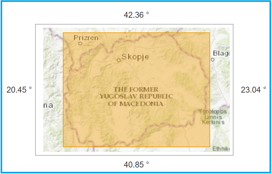

I am trying to create a new coordinate system for my country R. Macedonia with the following parameters:
The data on the geodetic date in which the topographic maps are made are:
- Spatial Reference System: State Macedonian Coordinate System,
- reference ellipsoid: Bessel 1841,
- equatorial radius (a): 6377397.155 m.,
-polar radius (b): 6356078.963 m.,
- inverse flattening f : 299.1528128156, 1 / f =0.003342773154
- cartographic projection: Gauss Krüger,
- Reflection zone: 7,
- the initial meridian: Greenwich,
- centered meridian: 21º 00'00 ",
- Beginner trainer: Equator,
- Size factor along the central meridian: 0.9999,
- value of Y along the central meridian: 7500000 m,
- the value of X along the initial compartment: 0 m,
- Unit: meter,
- Horizontal date: Hermannskogel, and
- vertical date: middle sea level.
-a way of transformation (WGS1984 -> Bessel) Versa-wolf
- Transformation parameters
dx = -521.7476m,
dy = -229.4892m,
dz = -590.9207m
rx = 4.02878 ",
ry = 4.48836 ",
rz = -15.52067 "
s = 9.7803 ppm
- the width of the meridian zone 3 °
Please help with instructions of total process.

Pointdump
Dejan,
Here's how to add that Bursa-Wolf Transformation to your Map Library:
Use <<<_MAPSCREATE DATUM>>> to name your new Datum and select the Bessel 1841 Ellipsoid.
Use <<<_MAPSCREATE GEO>>> to start the assistant to define the Bursa-Wolf Geodetic Transformation. (I don't know what the difference is between "Coordinate Frame" and "Position Vector")
From there, Duplicate and Edit the MACED-7M-S9 Coordinate System to include your new Geodetic Transformation. (Note: In the description of that CS, it says it uses a Scale of 0.9999, but it doesn't, so you'll have to make sure to use a 0.9999 Scale.)
Dave
Dave Stoll
Las Vegas, Nevada
NVIDIA Quadro P5000 16GB
Message 7 of 27
Pointdump
Oopsie! Under "Specify Useful Range" in "Create Geodetic Transformation" I screwed up. I grabbed some numbers off the Internet and reversed the Lats and Longs. Here's some better numbers for Useful Range:
WGS84 bounds:
Min Long:20.25, Min Lat:40.5
Max Long:23.25, Max Lat:43.0
Dave
Dave Stoll
Las Vegas, Nevada

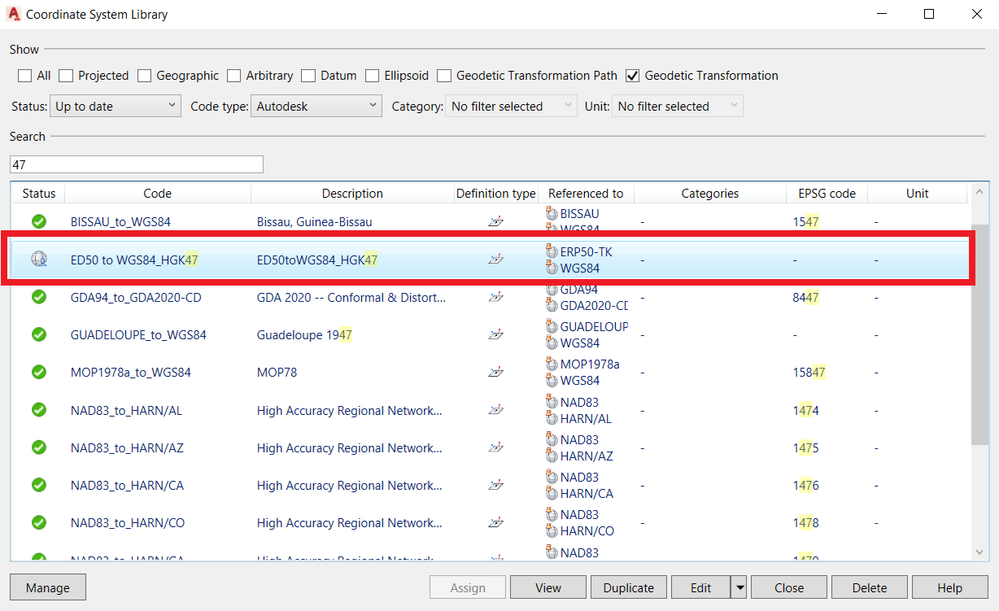

Message 9 of 27
erkanca
Hi @Pointdump;
I applied all steps in your post. I produced a Geodetic Transformations like MGI-Hermannskogel_to_WGS84 in your post. However i cant apply to my project. I dont know how its usage. Tu run this transformation what should i do?. I read your another post: https://forums.autodesk.com/t5/civil-3d-forum/add-coordinates-system-with-geodetic-transformation/td...
However i couldn't achieve. How can use Geodetic Transformation?
here my example exist: ScreenShot - 2023-03-30 123231_.png

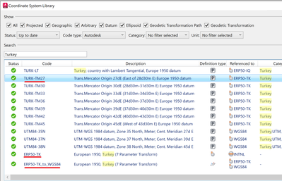

Thank you @Pointdump;
Thank you for your welcome. Infact you helped me many times thanks again. I am not new. I entered company computer and account. So i seem new.
I want to make transformation from ERP50 to WGS84. As you explain in other post i created a copy of ERP50 as shown in the photo: However there is no EPSG code is available. Is it possible to add that manually

Message 17 of 27
erkanca
I ll try your advice.
I wonder usage of ERP50-TK_to_WGS84 (Red underlined at the bottom of the photo that you shared). How it can be used.. When we apply a coordinate system we use assign button. How i can run ERP50-TK_to_WGS84 transformation?
Message 18 of 27
Pointdump
Erkan,
ERP50-TK_to_WGS84 works in the background without you needing to do anything. Just use MAPCSASSIGN to assign TURK-TM27 to your drawing and that's it.
