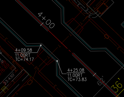

Good afternoon,
I have a question about alignment offset labels. Please refer to the inset:
I can label offsets (such as top of curb) we created an expression to add to the offset label the elevation of the TC (basically it reads the elevation of the road surface and add 6"). I would like to create a style to label TAG numbers instead, then extract the alignment station, offset and TC elevation from the tag and show the information on a table.  Thanks in advance.
