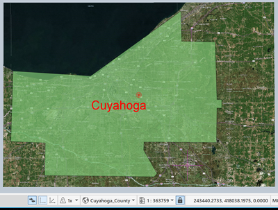

Jeff,
There's 2 ways to create a new coordinate system. You can Duplicate, then Edit, an existing similar coordinate system. Or you can create one from scratch with command MAPCSCREATE, which walks you through with a wizard. Either way, before starting, you'll want to do a few things. In UNITS set highest precision. In Ambient Settings set Lat Long to Decimal and bump precision up to 8. Bump Coordinates precision up to 8. And then figure out the extents of your new projection. You can drag-n-drop a shapefile of a county into a drawing and use MAPTRACKCS to give you some numbers.
Here's a few screen shots of creating a custom projection for Cuyahoga County, where I was born.

Cadguru42
I'm having to do just this on a project, but Ohio has decided to make things very complicated. @Pointdump should appreciate this. The new project has been surveyed in Cuyahoga County's new LDP system, so I have to create a new coordinate system for it. But the surveyor (they won't tell me who) provided a C3D drawing that has the C3D unit set to US Survey Feet, no coordinate system, and the AutoCAD unit set to Feet (International Feet). So I start asking questions about why the ACAD unit doesn't match the C3D unit and what coordinate system was used to create the survey. The surveyor's response (2nd hand) said "It's in feet. Not international feet nor US survey feet." Is there a 3rd foot unit definition that I'm not aware of?
I'm going to create a new coordinate system for this and the surveyor insists that he shot everything in US survey feet even though the ACAD unit was International Feet.
So, two things.
1. Assuming the points and figures are placed correctly in the model space to match the CS, I should be able to just add the new coordinate system and set the ACAD unit to US Survey Foot and be good to go, correct?
2. If the NGS dictates that all of the new state planes are to use International Foot, why is Ohio using US Survey foot?

"I should be able to just add the new coordinate system and set the ACAD unit to US Survey Foot and be good to go, correct?"
Should work. You'll definitely want to check a few NGS Control Points. The difference between the two units would be glaring.
