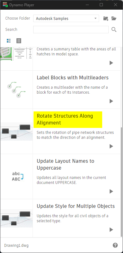

Hi @faisalWJ8Y9 and @cwitzel5NL5H
If you are working on Civil 3D 2025.1 update, there is a sample Dynamo graph that will rotate structures perpendicular to a given alignment. It's available in the Dynamo Player samples, but you can also explore it in Dynamo as a good starting point:
@paolo_rotaFK7DE the Object.SetRotation node in Dynamo > AutoCAD shelf can be used to rotate many different Objects, it's not specific to Structures, but will be able to assign the rotation angle of a structure!

Message 11 of 13
paolo_rotaFK7DE
Thank you very much, this node "Object.SetRotation" will be very useful
