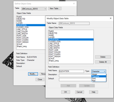

willem.creffierKCWFB
Hi @filip
yes, reading the values of extended data seems useful, but apparently it only exists for Map features or Cogo Points.
Did you proceed on this?
Kind regards,
