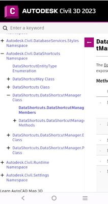

Hello everyone,
I was wondering how to create a data shortcut for Civil3D objects such as alignments, surfaces, etc. using the Civil3D API because I couldn't find a method to automate this process.
Any suggestions?
Thank you in advance.
495 Views
hosneyalaa
khaled.al-agamy
I want to create a data shortcut from a drawing to use it in another drawings, I know there is a method to create a reference from data shortcut, But I can't find the member to create data shortcut for that reference from the original drawing.
hippe013
To create a Data Shortcut you can use the SetSelectItemAtIndex method of the DataShortcutManager. The index you use is the same index as used in the method GetExportableItemAt. After setting the DataShortcut you will need to save the DataShortcutManager using the DataShortcuts.SaveDataShortcutManager method. After saving the DataShortcutManager you will need to refresh the shortcut node using the "RefreshShortcutNode" command. I hope this helps to get you going in the right direction.
