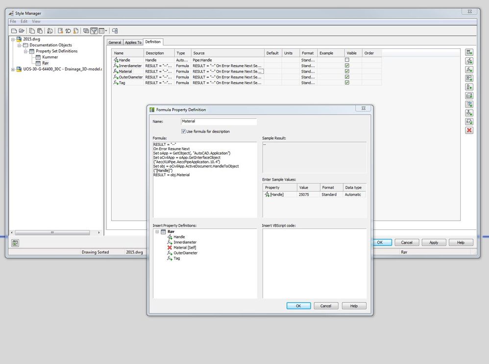

I am having problems with my property set definitions.
As an example i would like to make the object name visible when i do an export to 3D solids.
I am able to do this in Civil 2018, but I have to use Civil 2015 for this project.
This code works for Civil 2018:
Code start..
RESULT = "--"
On Error Resume Next
Set oApp = GetObject(, "AutoCAD.Application")
Set oCivilApp=oApp.GetInterfaceObject("AeccXUiPipe.AeccPipeApplication.12.0")
Set obj = oCivilApp.ActiveDocument.HandleToObject("[Handle]")
RESULT = obj.Name
Code end..
I have figured out that AeccPipeApplication.12.0 is for Civil 2018, but what code is to be used for Civil 2015?
Any help on this issue will be appreciated

Firstly, your question has nothing to do with Property Set. Since Property Set is a rarely discussed topic, mentioning Property Set in the title may lead people to simply skip your post's detail, if they know not much about Property Set.
The program ID for COM object AeccPipeApplication in Civil2015 is "AeccXUiPipe.AeccPipeApplication.10.4"
This code work with my Civil2015:
Public Sub Test()
    Dim cadApp As AcadApplication
    Dim pipeApp As AeccPipeApplication
    Set cadApp = ThisDrawing.Application
    Set pipeApp = cadApp.GetInterfaceObject("AeccXUIPipe.AeccPipeApplication.10.4")
    If Err.Number <> 0 Then
        MsgBox "Accessing to Pipe Application failed."
    Else
        MsgBox pipeApp.FullName
    End If
On Error Go 0
'' TO DO .... End Sub
Actually you can get the hint from the folder name where the Civil3D COM type libraries are installed (notice the number suffixed the folder name)
for Civil2015, it is
C:\Program Files\Common Files\Autodesk Shared\Civil Engineering 104
for Civil2016, it is (my guess, I do not have it installed)
C:\Program Files\Common Files\Autodesk Shared\Civil Engineering 105
for Civil2017, it is (my guess, I do not have it installed)
C:\Program Files\Common Files\Autodesk Shared\Civil Engineering 110
For Civil2018, it is
C:\Program Files\Common Files\Autodesk Shared\Civil Engineering 120
HTH

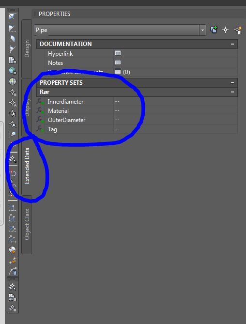

I might have explained a bit badly, but i am having problems inside the  PROPERTYSETDEFINE area..
If this has nothing to do with property sets, I have misunderstood the whole operation I am trying to do.
I have to export my Networks to 3D solids, but i also need some information in the exported model.
I might be way over my head here but the coding i have found online looks like this:PROPERTYSETDEFINE.JPG
As far as my researh here goes i need to do this operation to get the data in under "Extended Data" or else the 3D solid model will have no information attached to it
cwr-pae
Make sure you have the proper object type selected for the property set to apply to. Apply to everything to verify it an be applied to the object type in question.
In the formula select where it has [handle] and highlight it. Then double click the name handle in the Insert Property Definitions box. It should replace the word handle with a link to the handle property in the Insert Property Definitions box, the link has a very faintly grey background when its linked. I can't tell if the you have the proper link in your image.
Next you have to verify the property:
Run this lsp routine and look for the properties you want read for the property set. Not all properties can be read. To make sure of spellings, text can be copied from the F2 window to the formula. Note I renamed the command to odump to avoid conflicts with other routines.
