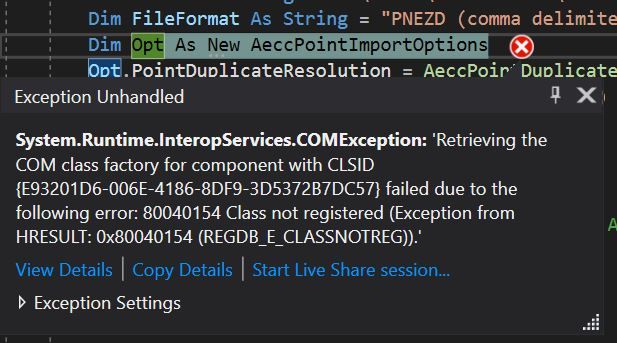

please if any one can help me ... i wiring an application for import the csv files to civil 3d automatically but come an error i do not know the reason. the image in the attachment
this my code:
Dim AcadApp As AcadApplication = GetObject(, "AutoCAD.Application")
Dim CivilApp As AeccApplication = AcadApp.GetInterfaceObject("AeccXUiLand.AeccApplication.11.0")
Dim Document As AeccDocument = CivilApp.ActiveDocument
Dim Points As AeccPoints = Document.Points
'Import File
Dim Opt As New AeccPointImportOptions
Dim FileFormat As String = "PNEZD (comma delimited)"
Opt.PointDuplicateResolution = AeccPointDuplicateResolutionType.aeccPointDuplicateOverwrite
Points.ImportPoints(""C:\points_data.csv"", FileFormat, Opt)

i do not think the problem in Civil 3D ProgramID (xxx.11.0) . because i useing civil 3d 2017 already . also some codes working well like add cogo points,points group,point style .... or get any information from the currently drawing no any problem come ... but the problem only coming with import point file
exactly in (Dim Opt As New AeccPointImportOptions) as shown in the blow image.
* my EXE is executed  as regular desktop app by the current log-in user

Ah, I see what you mean. It is this line that generate the error:
Dim opt As New AeccPointImportOptions
The error message actually provided hint "...class not registered...", which I did not think too much and jumped to the usual suspect of
... = AcadApp.GetInterfaceObject("AeccXUiLand.AeccApplication.11.0")
The reason of this error is that NOT ALL AEC/AECC classes can be instantiated from outside of AEC/AECC context by " As New xxxx" or "Set xxx = New ....". Just as you go with AeccApplication, which you cannot do
Set civilApp = New AeccApplication
You have to do
Set civilApp = AcadApplication.GetInterfaceObject("xxxxxxx")
Because these objects are already instantiated in AutoCAD context as Aecc objects. The same applies to, you guess it, AeccPointImport/[Export]Options class. So, change your code to:
Dim opt As AeccPointImportOptions
Set opt=AcadApp.GetObjectInterface("AeccXLnad.AeccPointImportOptions.11.0")

Sincere thanks and appreciation to you ..
this solution already working well without any errors. really a lot of time spend to solve this problem more than three months.
