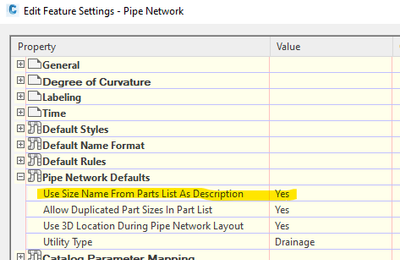

complicated problem, hopefully I can explain it well enough.
I would like my pipe networks to automatically label my pipe structures with very simple description. is there a way to change the structure description in the parts list for each individual part so that i can modify my label style to take that description and use it as a label?
i would like my water valves to say "WV" and my tee's to say "TEE" with out needing to manually change the label style every time i place a new part.

tyronebk
Would this workflow work for you?
Change this setting in Toolspace > Settings > <drawing> > Pipe Networks > Commands > Edit Feature Settings to Yes:
Now, when you add or swap a part the description is populated with the text specified in the parts list name column:

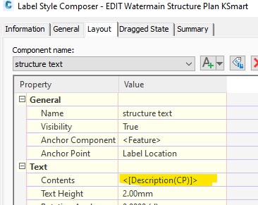

You can now create a very simple label style that only calls out the part description (along with anything else you need to include):
That single label style will now display this:
lkrznaricX6MEV
exactly what I needed. Thanks!
