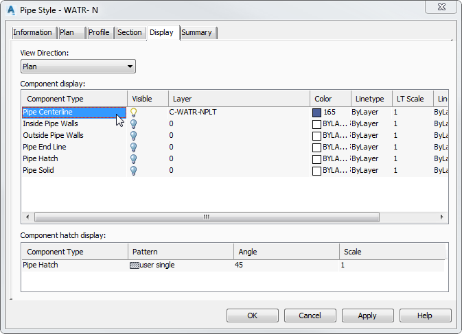

I'm trying to write a lisp that would change the Pipe Centerline layer and color as shown below.

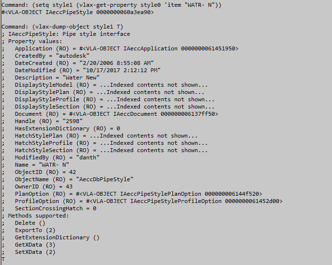

I tried a vlax-dump-object on the style, but I don't know how to find the correct syntax when the "indexed contents not shown"
Has anyone seen a lisp that accomplishing something similar to this, or does someone know how I can find the correct syntax for the non-vla-objects?
Thanks.

To get an item that is indexed use the following:
(vlax-get-property style1 'DisplayStylePlan i)
***Where "i" is an integer index beginning at zero***
Though I am thinking that what you are trying to do is not possible or "not exposed?". I was doing some testing but I was coming up with invalid pointers.

Thanks @hippe013. That got me going in the right direction. Below is what I came up with. It modifies the layer and color of the plan pipe centerline display. Color 256 is bylayer.
