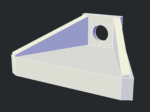

Sometimes I find it easier to just manually draw a headwall structure as a 3d Solid. Civil 3d has the capabilities to make headwall structures, but they can be frustrating to work with at times. I find just manually creating it as a solid and then draping featurelines over it to project to a profile view or section view is sometimes much easier with fewer headaches.

hippe013
Making solids such as what I posted requires some previous knowledge of working with solids in AutoCAD and modeling in 3d. Commands that you need to be familiar with are extrude, union, subtract, as well as being familiar with working is different User Coordinate Systems (UCS). Do you have an existing drawing showing dimensions of a head wall with wing walls or are you needing to design one from scratch?
