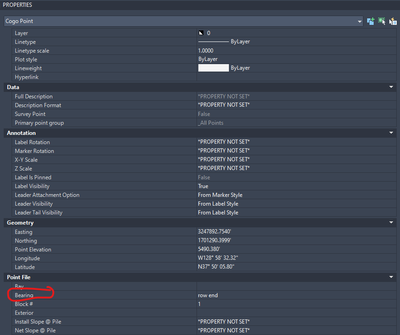

I am trying to edit a script that I have to also write the COGO custom property from below:
Here is my code. everything works except for the (setq bearing (vlax-get-property cogo 'Bearing)) line. Is there a way to export these custom properties in LISP?

'Bearing is not a property of a COGO Point. You might need to use an angle function to calculate the angle between points. What is it you're going for with Bearing?

This is a custom property, I am looking for the text string that was assigned to the Bearing property in the image above, not rotation.
Jeff_M
@carl3ZPF6 is the Bearing property a UserDefinedProperty? Can you post a drawing with a few of these points in it?
carl3ZPF6
Yes user defined. See attached drawing.

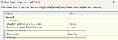

Ok, 2 things need to be done. First, you must assign the Classification to a PointGroup the points are in...in this drawing's case, the "_All Points" group (note that older releases of C3D did not allow assigning the classification to this group). If the points are not in a group with the Classification set you will get an error.
Second, change the line to get the Bearing to this:
(setq bearing (vlax-invoke cogo 'getuserdefinedpropertyvalue "Bearing"))
Note that if you want to get other UDP values the UDPs are case sensitive. This fact has caused others much frustration in the past.
