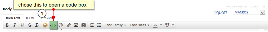

Note in the fututure when posting code please use the code window on the Rich text tab see image it helps the other posters
