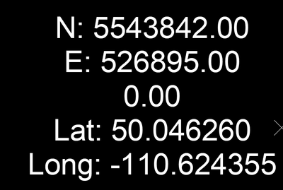

So this code works but puts block coordinates in the improper location, My EXIF data is lat and longs in DMS, not sure if this is converting to DD? then I need to project that value forward into my current coordinate system in my drawing. Sample Photo EXIF Data Details and code, Block name is Test and it is not dynamic.
This is where it should end up at least in my drawing

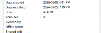

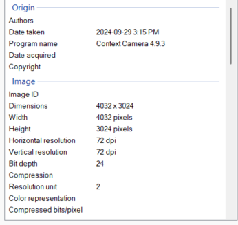

@RickfromtheNorth , can you provide example photos of the image?
Message 7 of 12
RickfromtheNorth
I can't really supply the image but here are some screenshots of properties.
Message 8 of 12
