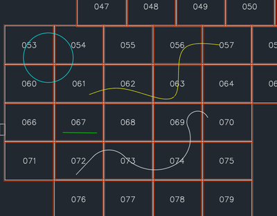

Is it possible to select exploded objects using the select window?
I'm trying to explode and select certain area base on the selected objects. Then those selected object will be save and the rest will be ignored.

What I mean is like this.
var region = (Region)tr.GetObject(id, OpenMode.ForWrite, false, true);
var objects = new DBObjectCollection();
region.Explode(objects);
// Here I will select base window mPt1 and mPt2. I tried this but it didnt get the objects from the exploded
PromptSelectionResult mBoxSelect = ed.SelectWindow(mPt1, mPt2);
foreach (ObjectId oInBoxId  in mBoxSelect.Value.GetObjectIds())
Message 4 of 13

alexisgacia
I'm trying to identify the label inside the sheet. Using the boundary of the line, I will able to select the object and Identify the label that I marked. In this case (063, 064, 067, 068, 069)

I attached the DWG File as reference.
User Steps:
Select BlockReference as BlockSheet
Select Target Entities (Circle, Line, Polyline, SPLine)
Desired Output:
Circle (Cyan): 053, 054, 060 & 061
Line(Green): 067
SPLine(Yellow): 056, 057, 061, 062 & 063
Polyline(White): 069, 070, 072, 073 & 074
Block <BlockSheet>: Contains Polyline and Text
Polyline ("A-TITL-TXT2" & "Z_DWG_SHT")
TEST ("Z_DWG_SHT_NO")
My idea on the process:
Explode the BlockSheet to SheetCollection
Remove any objects except objects having layer ("Z_DWG_SHT" & "Z_DWG_SHT_NO")
Loop through to Selected Entities
(SelectCrossing or Alternative function) using boundingbox of the entity as Crv1 to identify the objects in SheetCollection.
(SelectCrossing or Alternative function) Using the boundary of the entity as Sheet having layer "Z_DWG_SHT" from the sheetCollection to check if Crv1 exist in the selection
Once Crv1 exist grab the Text with layer "Z_DWG_SHT_NO"
Currently I don't have an alternative function that can SelectCrossing in the Collection.
Below is the sample code that I did

Message 12 of 13
Jeff_M
@alexisgacia Is the new code doing what you want? I got called away for a family emergency so have not had a chance to look into this further. Your new code is doing pretty much what I was going to attempt. The last step for the text would just loop through the text objects and see if the insertion point is inside the 'selected' sheets.
Message 13 of 13
alexisgacia
Hi @Jeff_M,
Good day.
Sorry for the late reply. It works well for me.
"The last step for the text would just loop through the text objects and see if the insertion point is inside the 'selected' sheets." Yes this is what I did.
Thank you very much.
