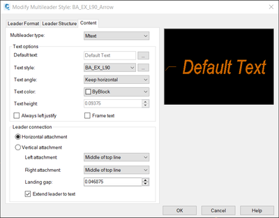

The leader style is
And my Text Style is:
