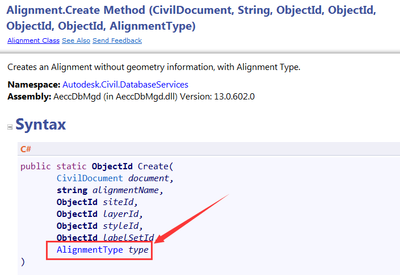

Hi guys,
we got into big trouble. We are trying to create RAIL alignment (just one curve) using API method and there is no possibility to set Alignment Type... So please could you advice me how to do it. We need Rail because of cant... The way using corridor is crazy...
Martin

Jeff_M
Joan, the AlignmentType property is Read-Only in the .NET API and it's not even available in the COM API.

Hello guys,
I got response from Autodesk support, there is no API support for that 😞
Martin
465340553
Can you use this method to create alignment?
Specify AlignmentType here.
