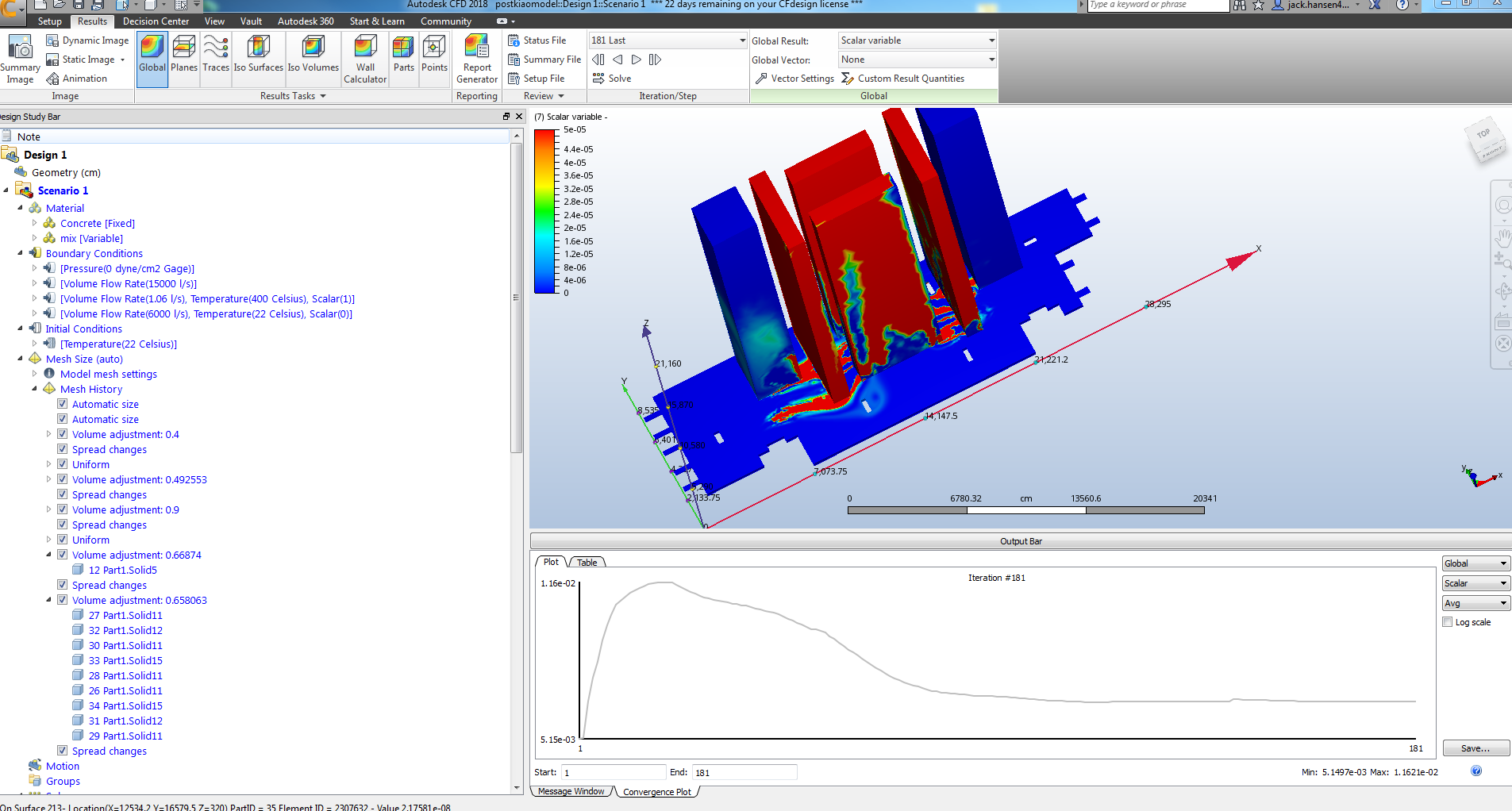

Hi Guys,
Just uploading the latest model and a screenshot of it's result:
This is the best result I have got so far, in this instance I supplied volume flow rates through the side outlets, I had a positive pressure at the two side ramps, positive pressure for the inner 3 extrusions, and a P= 0 outlet among these extrusions to allow the model to balance itself for mass conservation.
also added some temperatures and activated natural convection and gravity. Should my inlets with a Volume flow/scalar also include a temperature? or will that be over constrained on an inlet?
The scale is at 50 ppm, noted that changing the scale down still shows very high values of scalar for the bottom area, still - a much better result than what I have been achieving.
Please see attached,
Regards,
Jack
Message 44 of 53
Hi again,
Attached latest model that produced the best results so far, although there was very high ppm CO right near the CO outlets, but nowhere else - a better result. This is using volume flows in/out and having 2 p=0 ramps to allow the system to balance.
Kind regards,
Jack

Hi Jack,
We are looking into this here also so do not feel that you need to run models there.
Your numbers are not the same as what we discussed on the phone, you have 60,000 l/s moving through the model now, is that the final figure that we should be using?
Please do confirm this as we were using 46,400 l/s after we spoke.
I also need to comment on some of your boundary conditions:
Simply, all inlets need Scalar, Temperature and either a Flow or Pressure Condition.
All outlets need either a P=0 or a Flow Rate.
Your ramps must be pulling air in, 3000 l/s each based on the other boundary conditions but they have no Temp or Scalar. They do need these values for CFD to know how to initialise things.
The outlets should not have a Temperature or Scalar assigned. Please remove the Temperature conditions, the air would likely be a different value to this as we are adding heat to the model and CFD needs to calculate that itself.
The side and underside inlets all look OK to me though 🙂
I took a step back to see what is causing issues and ran without natural convection and scalars, which was interesting as it ran really smoothly with no recirculation over any P=0's. Now I am adding each back in to see which might be causing us issues.
Could you confirm what flow figures we need to be using again?
Is it what we spoke about or what you now have assigned in your latest model?
Jon

Hi John,
I was originally using 93000/2  (46 500) for exhaust and 73 000/2 (36 500).
The latest model I sent was me increasing the flow rates by arbitrary values to see if it would help get more of the CO out of the system, as using flow rates and pressure reliefs seemed to be giving me somewhat promising results - sorry to confuse you with that one!
I will assign only a flow rate out of the model now, and see how that goes with two P = 0 relief outlets.
When you removed the convection and other stuff, were you still seeing a high scalar result?
Hopefully speak tonight mate!
Regards,
Jack

Hi Guys,
Thought i'd just put up my latest run: It is definitely the best result in terms of keeping the CO lower, although there are still areas that have up to .01 scalar which is obviously far too high!
This model I used higher airflow to see if that would change the amount exhausted, I believe it does,
- 37M elements
- only took 181 iterations to fully converge.
Attached model and screenshot,
Regards,
Jack

Hi Jack,
Thank  you for letting us know your progress. I am so happy to see that you got a better result.
Actually, I did some testing on the model you originally sent to us. I am also thinking about increasing the supply air flow to dilute the CO concentration.
Below is my velocity result.
Given the position of the supply entrance and the volume flow rate, there are many areas that supply air could not reach to.
Therefore, we get a high CO concentration in this area. So my thought is to increase the supply air flowrate or change the supply air entrance to somewhere which can help mixing like shown in picture below.
Please let me know my thoughts. Also attached my model for your reference.
Thank you!
Xiaojin Zhang

Hi XiaoJin,
Thank you for your input, you got a result quite similar to mine.
In regards to the airflow supplied to the bottom of the car park - I see that it would help distribution if there was some air applied from the bottom of the area. I will  have to check with the technical manager on what I can do with this. I may rebuild the model slightly with perhaps different sized openings for the airflow inlets, outlets and carbon monoxide outlets.
There isn't a way to set the required scalar value inside the car park, and thus allowing the model to solve for a specific airflow at the inlets? Just to gauge what sort of number the model comes up with.
Have you heard from Jon lately? Would also be good to hear his feedback. Shall continue on.
Regards,
Jack
