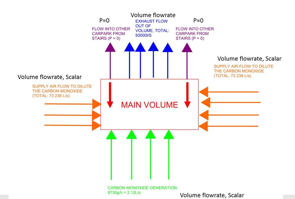

May I confirm with you about the number of the volume flow rate? If it is true, the P=0 boundaries are acting as inlets and also pulling air into the model.
I am wondering if the total volume flowrate of the air is 73238l/sX2?
Xiaojin Zhang
Message 27 of 53
Hi Xiao,
p= 0 as an inlet?! No as i have previously stated. there is a total of 73 000 entering air
there is 2.12 l.s carbon monoxide entering also
exiting should be 93 000 l.s but we cant add this in. we can only add p= 0 as an outlet. i thought we already concluded this? i also drew a diagram! please let me know if this cant be done.

Jon.Wilde
Hi Jack,
To try to be clearer here, you have 93,000 l/s being pulled out.
You have assigned 72,900 l/s in, split over 5 inlets at 8100 l/s each.
(Ignoring the minimal scalar 1 flows as they are near zero).
This means that you still need to add an additional 20,100 l/s to the model for there to be a mass balance. This is why CFD is treating those P=0's at inlets.
We need to have a mass balance. Could you help us to better define the model to guarantee this?
Something sounds wrong, where does the other 20,100 come from?

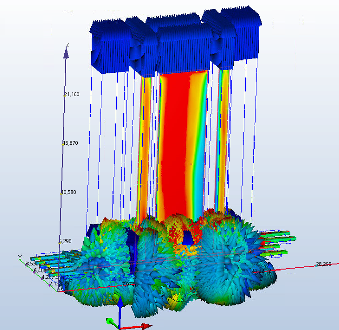

PS:
Pulling air out seems to at least give a stable solution with no outlet recirculation (of course, as it is now a flow rate), although I do have questions about the scalar values as above. I guessed the values for now as there is still an open question over what flow is going where to get a mass balance, which we must have.

In reality? There is a mixture of Air/CO that is leaving the exhaust ports at an increased rate to what air is being pumped into the space.
Usually when we design systems for these sort of problems, we have deemed-to-satisfy conditions the car park must adhere to, usually this is by doing a calculation which yields the Carbon monoxide generation rate, and in-turn a Flow rate needed as exhaust from the space - This is the 93 000 (note that number is actually for a car park double the space). The flow rate in is a percentage of the airflow in, understanding that air isn't entering/leaving at the same rate or at least this is how the fans are sized up.
In this case, we have:
8730 g/h, or 2.12 L/s Carbon monoxide generation.
The exhaust that was calculated using the deemed to satisfy clauses is 93 000, this number is rather arbitrary, It should be half of this to exhaust the amount of CO desired. I'm working with the larger number to try and get this model to work.
In reality I guess it is hard to tell what each flow rate will ACTUALLY be, but the fans would be sized for 93 000 exhaust and 73 000 Supply, I have never been involved with commissioning these systems or anything so I'm not sure how close the installed flow rates are compared to the theoretical.
If what you mean by realistic flowrate is my CO generation, then 2.12 L/s is this value (that would be scalar of 1 I assume), some of the other other ones I have split into multiple inlets and just divided the scalar by 500, hence the total CO generation would be 1060.
In regards to the mass flow, how are we to assign a flow rate out of the system that ensures balance? we have too many unknowns, the equation being as follows:
x(73 000) + y(2.12) = FLOWRATE OUT(x + y)
note that the volume of the entire space I have calculated as 54 400, so just roughly, the max concentration would be (2.425g/544000) or 44ppm.

Message 33 of 53
Dear All,
I'd like to upload the following screenshot,
Upon modelling a flow rate out of the model, and leaving inlets as P=0 so the model can balance itself, in the convergence plot window, it can be seen from the graph that there is a minimum value of scalar of 1.16e-2, this equates to 11 600 ppm, is this value showing me that the results have already exploded and something isn't right? as you can see using my scale the 50 ppm has already been exceeded.
This is why i went back to check a simple mass/volume for CO (equating roughly to the 44ppm as described above). getting this large value seems to be signifying something is wrong with the model, how is so much CO getting displaced when it's flow is so low? This happens regardless of whatever I try for my boundary conditions, very frustrating!
Having said this, assigning the flows out the top of the system and leaving the inlets as P = 0 is most likely my current best solution, despite it still inflating. Can I also verify - If i highlight 6 outlets and apply a 15 500 L/s, this is 15 500 L/s out of EACH inlet? not all the inlets combined, correct?
Regards,
Jack

Thank you very much for your reply. I understand than you have much concern about the scalar result. However, I would like to make sure all settings are correct before we dig in to it.
I want to make sure the followings first:
  1. Mass flowrate balance
The mass balance equation should be:
Supply air (73000) + CO (2.12) =Exhaust (93000) + Flow from P=0
Now we have more exhaust getting out from the model than the supply air, so there need air coming from the P=0 boundary.
I could not understand your equation. May I ask what do x and y stand for?

Screenshot and latest CFZ file of runs with differing pressure at inlets/outlets. This was the way that this was modeled (in a different program) in an earlier stage of the project I'm doing
Results have exploded all over the model. The pressure differential was the way that this other model had been done.
This newest model I have taken one of the outlets away and made it a P = 0 for balancing, please note before this I just had all the outlets as the 66.7Pa.
Also attached is a screenshot of what has been deemed to be a solved system, the red spots are 100 000 ppm (people being poisoned) - this is one of the reasons why I think the models just explode the amount of CO, that guy got a solution similar to me, He's just played with the legend. I am not happy to fudge the results like this man has done because this system is meant to keep people safe and there is a liability involved.
I am trying everything, please advise in writing if this program cannot model this exhaust system, I need to know this now as it is getting very late. Seeing from the other models on this forum I don't think this program can do what we want. This isn't a university project. It needs a result that can scale into real life and be relied upon.
Regards,
Jack
